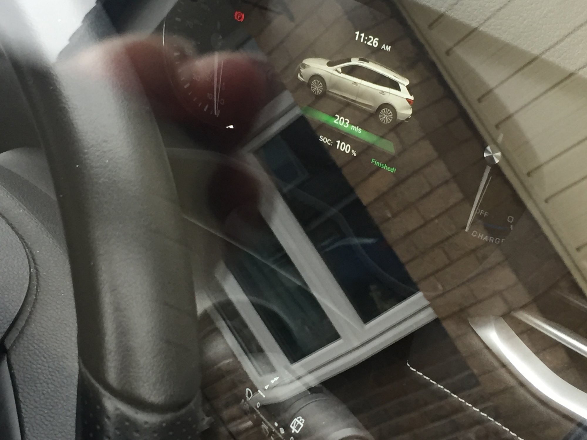

10:11 am car say SOC 100% 203 miles Finished.
But Zappi shows still charging at 1.4 kw
So I keep a check on it about every 15 minutes via the my energy App, and at 11:26 the car is still the same SOC 100% 203 miles Finished
Now at this time the Zappi is showing Charging but now at only 0.3 kw,so it is now doing a battery balancing session.
Then at 13:17 hrs car shows 100% SOC 203miles connected uncharged
And now Zappi shows charge complete with a flag.
