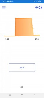

From my experience the EO Mini Pro is fully compatible as I can schedule a charge.
Ser latest chart below
