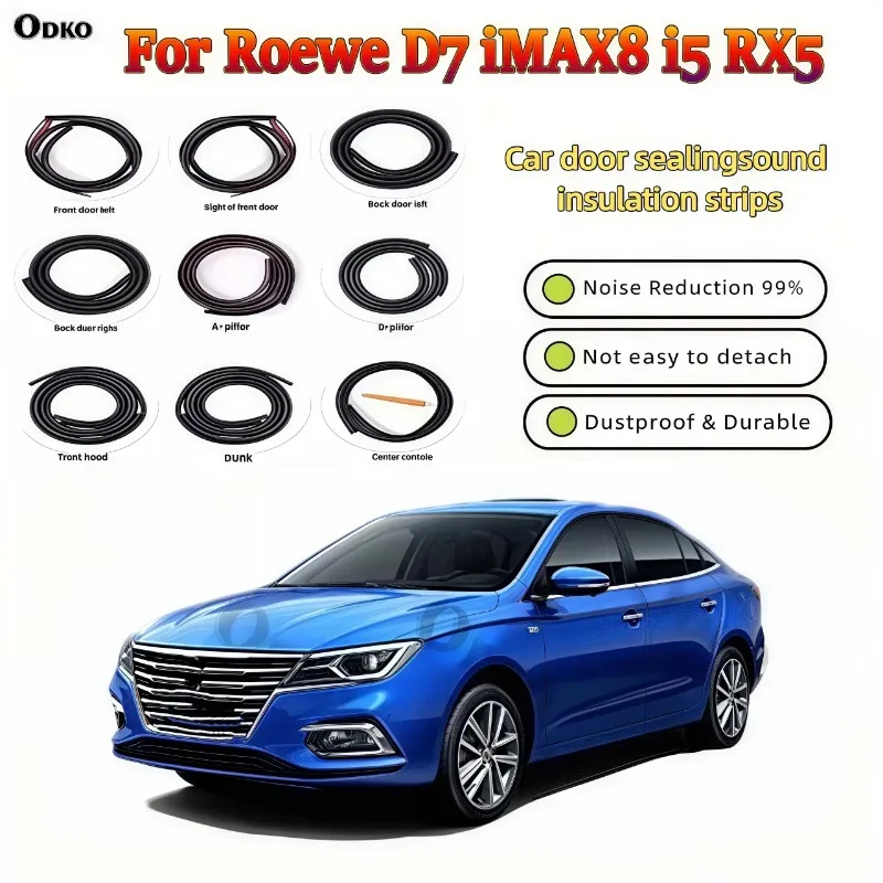

i had this almost every day until i checked for holes and damage in my door seals, found a few very minor ones that i covered with some cheap pvc electrical tape i had around. not had it since!
you can get new door seals from aliexpress or a nearby dealer though. usually searching "roewe ei5" or i5 yields what youll want, as the mg5 on china is a very different car 🙂
