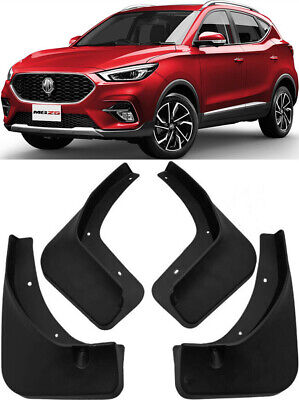

Finally - my AliExpress mud flaps - Rears of one of the sets I ordered fit (so yes there is a difference between the mrk1 & mrk2 on the rear bumper) - Great - But neither of the fronts I have are clearly not tall enough to marry to the factory trim washer press in nut thingy - & I'm not keen on screwing into the black plastic trim (incase I hit metal of the wheel arch panel) using the self tappers that came with the mud flaps ?!
Do MG do front Mud Flaps ?!

Mud flaps same across the years here.

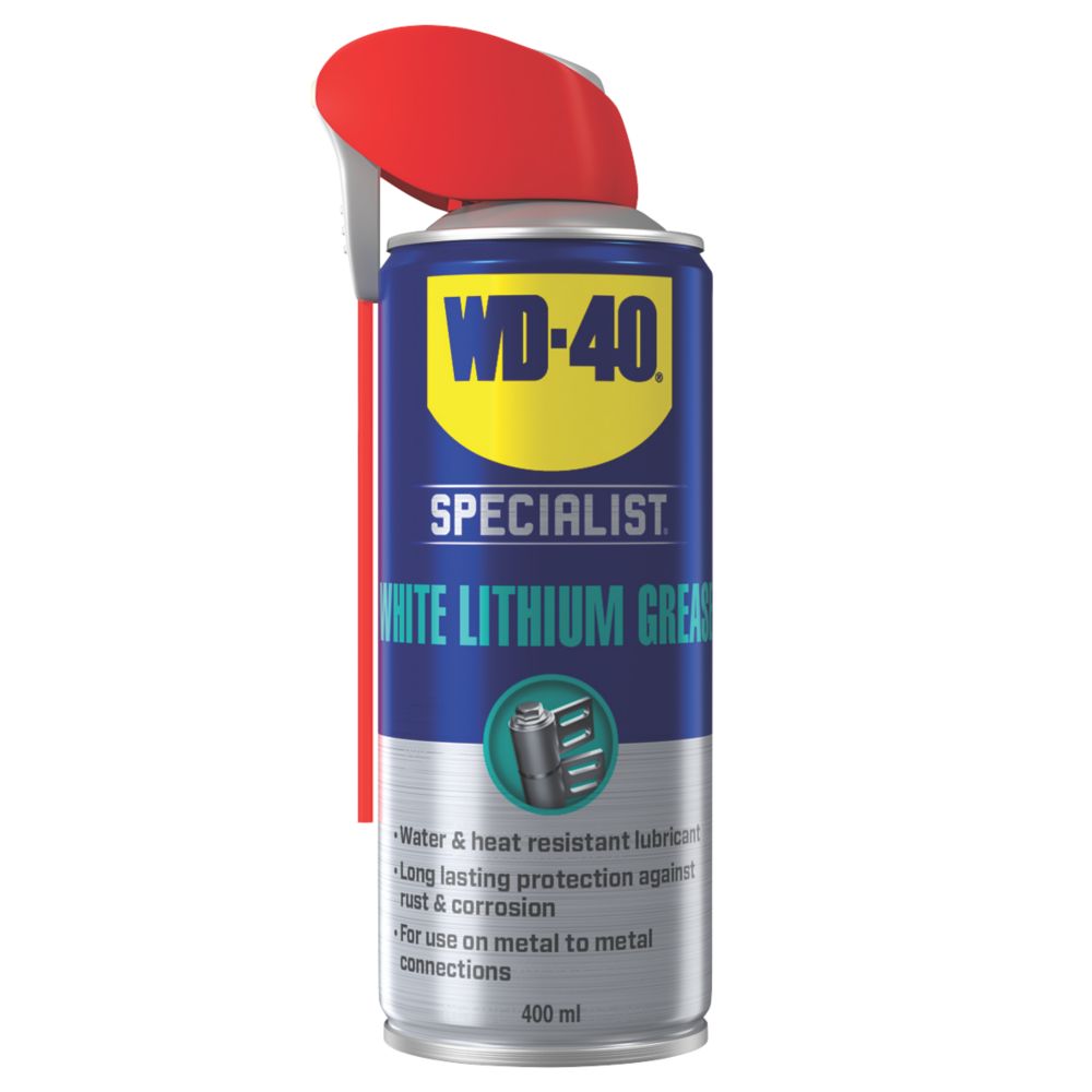

I went for a very short shot of WD40 first, then worked the handle in and out about a dozen times.
Then pulled out the handle and sprayed some of the WD White Lithium grease inside.
Repeat on every door one by one.
It’s a good idea to spray white lub into the locks / hinges and don’t forget the boot & bonnet catch’s.

The rear mud flaps are slightly different on the face lift model.
I think this is because the face lift has a slightly different bumper cover shape than the original model.
I think the front flaps are the same on both.
I had the MG flaps on our original model and they need holes drilling to accommodate the self tapping screws.
The ones that came with the flaps were only mild steel and started to rust within weeks.
I switched them out for some black coloured stainless steel screws.

Oh - Here is the spray grease I used.

I have WD-40 White Lithium Spray - But will grab some wd-40 to 'lube' up prior to applying into the handle aperture :)

When you say "I had the MG flaps on our original model and they need holes drilling to accommodate the self tapping screws" - That is into the plastic wheel arch liners that are visible from the side profile of the car?? - They had to be very Short stubby Screws to miss the Metal work surely?
Fitted to mine and the screws will self drill into the plastic. I purchased stainless steel screws as the ones which come with the flaps will rust quite quickly. Advise previously on the forum.
They where installed by the dealer, at the time of the PDI.
But I do believe if you drill through the plastic wheel arch, you will then enter into the metal work of the wheel arch as a result of this action unfortunately.

Hmm - I have a ponder on what could be the correct length screw to 'miss' the metal work ....
The wheel arch plastic is not that thick, I think even a short screw would bottom out before it bites onto the mud flap TBH.
The fronts must be the same I guess ?.
Once you drill through the plastic, you are then drilling into the metal of the wheel arch.
I wonder if you could fix them with some type of black seam sealer etc ?.
You would need to clamp them in place until the adhesive sets of course.
This would be more favourable over drilling into the metal bodywork.
