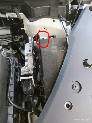

All you need is a screw from the control unit bracket. The one on the spring mount. Then you can bend the control unit slightly to the side (towards the engine) and the cover will come off. At least your garage was already aware of this; mine wasn’t.
