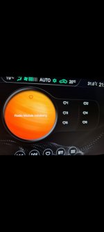

Im having issues with my radio in the last 2 months, error: "Radio module initialising".
Ive heared something about dab update that need to be done..
Someone know about it? Mg service center dont know how to fix it.

The dealership should be able to sort it. Initially, before all my other issues, they were going to fix it in about an hour but I won't know whether they have actually done it until I get my car back tomorrow.

I had the same issue. The only solution i found was to disconnect the 12V battery and reconnect it after 5 Minutes. If you do so, the radio will work again but you will have a lot of errors on the dashboard. If you drive 200/300 metters all the errors disappear. So dont be scared :)
hat leider bei mir nicht funktioniert. Vereinbaren Sie nächste Woche einen Termin mit dem Händler. Aber danke!
