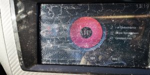

Mine has done exactly the same. Few bubbles over many months but now totally cracked look all over. Cannot see/use it in the sunshine. If you rub it with your finger tiny flakes come off. It's a 2018 petrol.
Google Gemini AI (I don't know its accuracy) says that this is the protective film, and that you should carefully peel it off completely to prevent damage to the screen.
If you look at the bottom right corner, it looks like protective film that started peeling off at the edges. Try puling it off and see what happens - and let us know please !
As mentioned above it started with blisters in the cold weather, ok beforehand. then while using the screen the protective cover just started to peel off in seconds and as a result only the little bits remained as the rest of the sparkling bits all came off, really scary especially because when I turned the car on the horizontal line appeard at the top which was even worse. Any clue what is that? They advised the same it's not covered under the warranty and anyway it's 5 years old .
It’s really strange that none of the posters have responded to the suggestions that the issues may simply be the screen protection film, which should have been removed before use.
