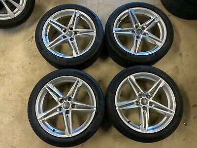

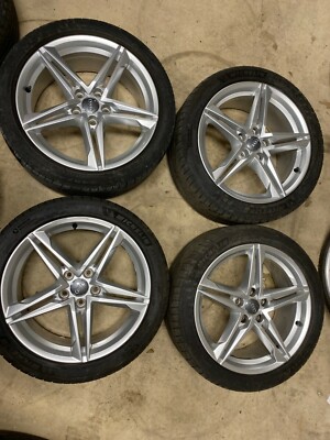

Do you have details about these wheels please?

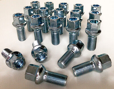

Thank you for the very comprehensive reply. Tempting.They are a direct fit, make sure to get the A4 wheels as the offset is nearly the same as MG, there is an A5 variant that will fit but has the wrong offset. You do need spigot rings, available for a few pounds, to drop the centre bore from Audi to MG diameter. You also must change the wheel bolts to the VAG curved seat type.
For mine I used a set of MG overlays available online. You just pop out the 4 rings on the audi centres, then stick the MG overlays on.
These wheels are 18", so to maintain a near enough correct size, you need 18" x 225/45, or 245/40 tyres. The car feels more original on 225/45's, steering feel is different with 245/40's.
Audi part number is 8W0601025R There's usually several sets on ebay at any given time.
Here's one example:
4 X Audi A4 8w B9 S Line 18" Inch Alloy Wheels 8jx18 Et40 8w0601025r | eBay

Bolts:
alloy wheel bolts nuts lugs M14 x 1.5 17mm Hex 27mm thread Radius seat Audi x 20 | eBay
M14x1.5 Radius seat 27mm thread 17mm Hex alloy wheel bolts. Fits a wide range of cars, see the compatibility table for fitment information. See the full description for more specs.www.ebay.co.uk

Thank you for the very comprehensive reply. TemptingThey are a direct fit, make sure to get the A4 wheels as the offset is nearly the same as MG, there is an A5 variant that will fit but has the wrong offset. You do need spigot rings, available for a few pounds, to drop the centre bore from Audi to MG diameter. You also must change the wheel bolts to the VAG curved seat type.
Here's one example:
Find many great new & used options and get the best deals for 4 X Audi A4 8w B9 S Line 18" Inch Alloy Wheels 8jx18 Et40 8w0601025r at the best online prices at eBay! Free delivery for many products!www.ebay.co.uk

Bolts:
