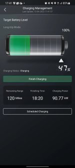

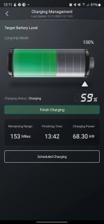

I'll put two screenshots, one is from April and one this weekend.
This weekend was a chilly one about 6 degrees sl was fairly cold for the battery to reach peak rates. Second screenshot was from spring time so a lot warmer temperatures.
