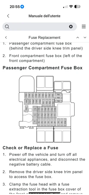

Check the fuse F7 in the passenger compartment. Also, if you have or want to buy a VDI you can try a reprogram via sips.
Thanks, I'll check the fuse tomorrow, I honestly didn't think it was a fuse with it being an intermittent fault that's got worse over time but definitely worth checking.
