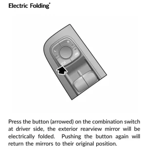

Wanted to go to our local automated car was today but couldn't for the life of me figure out how to fold in the wing mirrors without locking the car since it needs to be in neutral with no parking break whilst in the car wash. Anyone shed any light on how to do this? I've spent hours now googling this without luck.
You can also push them by hand to fold and pull back to open again

only If the mirror fails to fold and you really need it folded for whatever reason.
