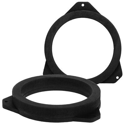

...then I saw this other guy at youtube using these spacers from a Citroen Berlingo 2008 or Peugeot Partner 2008
and for some reason Amazon in US (where im able to buy) doesn't list french cars... weird.
Anyways, after researching I've found them in eBay for $18.51 but the shipping is $57.80 O_O
No way im going to pay that... it's too much :\
But i do notice these are MDF and not plastic... is this better?
Anyways, what else can i use to add aftermarket speakers 6.5" for our MG4 ?
Please share links of what works and that i'm able to buy from the US market (Im from Ecuador, and that's the way I can bring stuff to my country... since here i wont find anything similar)
