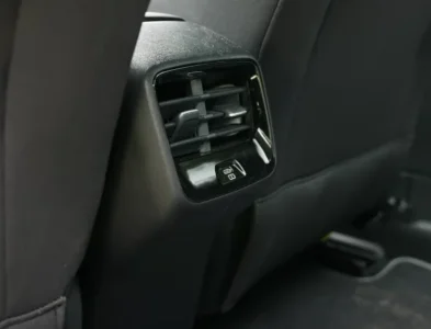

The 'mirror' ports are 2A, so 10W.
The rear port (back seats) is 3A, so 15W.
This info is from the User Manual. I hope this helps.
