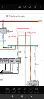

Joehn. Is this the same pin outs you used for your hitch connector (red markup and red text)?
