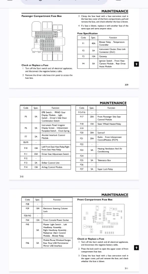

Not sure if this helps, don't have one but a quick Google search and I was presented with the owners manual for ZS hybrid plus:

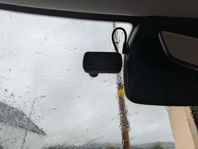

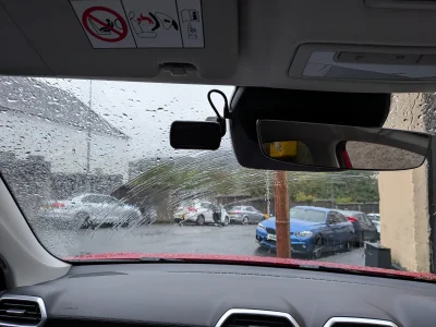

The USB is only live with the ignition. See photos attached as promised (it's a bit wet this evening to take one from the outside! ☔). I recommend those short USB cables for use with a Nextbase dash cam - excellent.
If you decide to hardwire into the fuse box, I would recommend piggybacking off fuse 46, which is the fuse the USB port in the mirror assembly uses.
