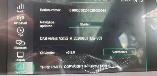

It is on the same screen as the software, you just need to swipe up on the touch screen there is more below the information you posted. I wonder if the RHD software is different to the LHD for the ECU. Maybe as it's Chinese the RHD software was written later or by a different team.
Rather stupid of me! It happened before... Must watch te green indication line more often!
Second try... I think there is no difference?
