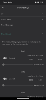

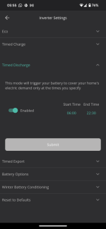

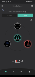

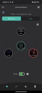

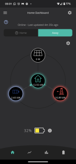

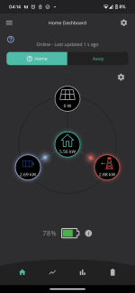

Bam Bam, one more for you, hope you can help! Although we managed to get the battery charging overnight along with the intelligent octopus time, the discharging schedule is not working at all. Have you encountered this before? I attached some images to show that the battery does charge overnight, but it starts discharging before 6am (the schedule I've set for it to start discharging). Basically it's charging early in the night and discharging in the same off-peak window (aside from the EV, I have a heat pump so I'm using energy during the night at a time that I would like the battery to be filled instead of used)
The screenshots show that at 2am it's 90% charged, at 4am it's already discharging and used up a lot of battery, by 6am it's completely depleted.

Quite a tough question.
Is the issue that there is unwanted discharge from battery to car during the night?
In general I would say you should firstly make sure you've got the battery set to full charge at all times during the off peak period. That should cover the problem for the usual period.
I guess your problem will be that the car charging will sometimes happen at times outside the standard off peak window and you can't anticipate these in advance. The battery will see a load during those times and attempt to meet it.
I had this happen when Octopus had a free electricity window. I charged the car but it took it from the battery because it wasn't set to full charge during that time window.
I suppose the ideal would be that Octopus would change the settings on your inverter at the same time as they change the settings on the EVSE. You could ask if they would do that - they do have integration for Octopus Flux after all so you could give Octopus access via the app.
I don't use the 'discharge' function myself because it didn't seem to make any difference to anything, perhaps due to my other settings like 'cover house load.'
I assume you don't have a Givenergy EVSE [you said Ohme above].
Sorry that is a very limited solution. I would contact Octopus and maybe Givenergy and also check out the Givenergy forums as there are more experts on there.
I left the EV unplugged this week to ensure it wasn't interfering. The app is intuitive so I think the discharge schedule is set appropriately (ie to not discharge during off-peak hours) but it's just not working. I will attempt to contact Givenergy. Thank you once again.
