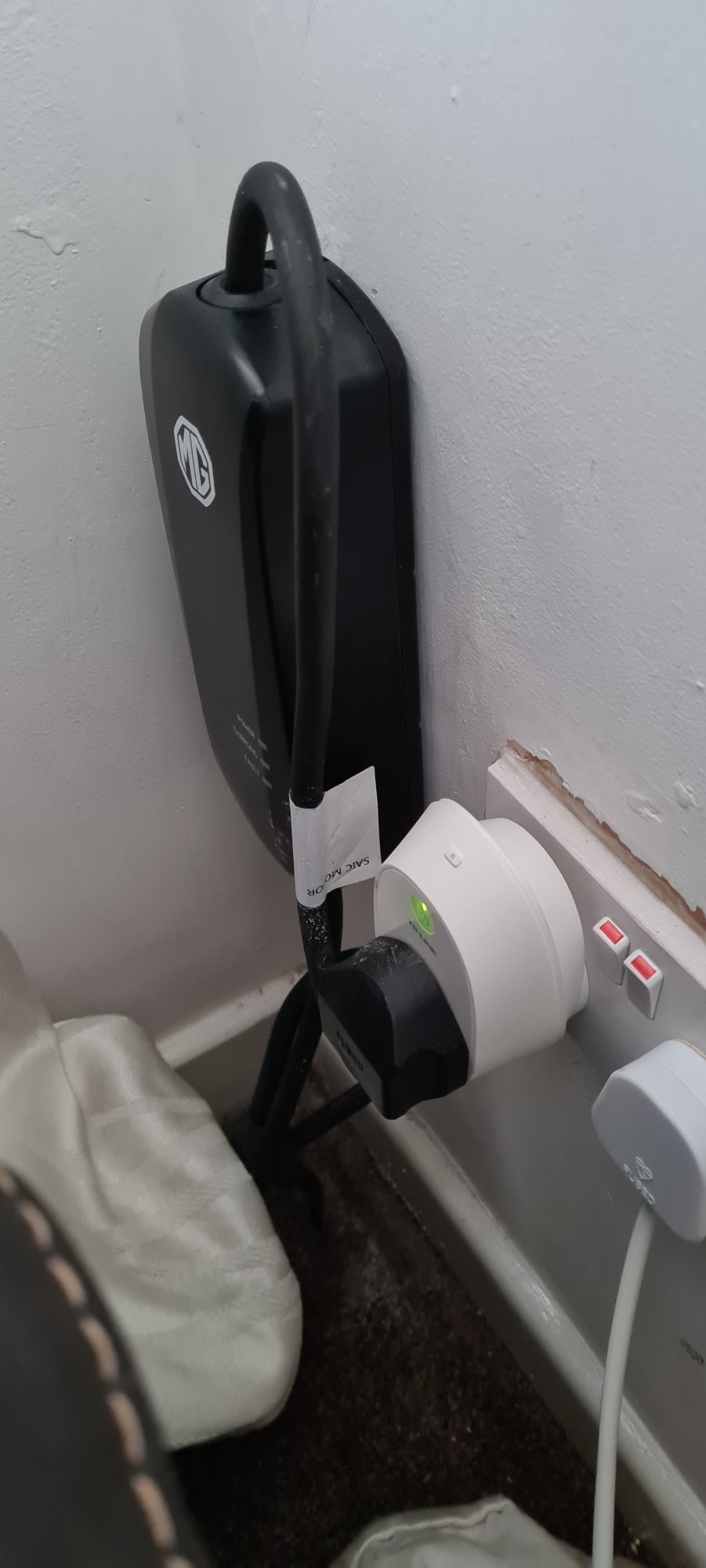

Morning all, I decided to hardwire in my granny charger due to my house being electrically looped with next door and the cable going under our garages so couldn't be done, I am happy using the granny as I only do around 30 miles each day so happy to charge every few days.
What do you think ?
I have connected using a TP link that way I can turn the charger on and off by my phone 📱🙃
Looks good as long as the TP can take the current ok. What do you do if you go somewhere and they don't have any charger that you can use? I keep the granny charger in the car just in case I go anywhere and need to use it.

I don't go that far in the car mainly commute to work, I have a bigger diesel car for long family days out.
I have a type 2 cable in the car for charging elsewhere.

Not really done it for the TP link, it was more about the granny not getting stolen and keeping the main unit waterproof.
Best of both worlds

That's a nice neat setup. Can't see anything wrong with it at all.
I would do the same thing if I were not going to get and need a 7kW, it's a pain having to get the granny charger out/put it away every day as I can't leave it securely outside.
It sounds like the smart adapter you're using is up to the task, do have to be a bit careful with these things as they're not really intended to run at maximum rated current for long periods of time.
I know of several remote control sockets that have failed due to overheating and I conclude they are probably not capable of supplying (say) 13A on a continuous basis. Personally, I just leave my granny plugged in and turned on. As a switch mode power supply on no load it will use very little power at mains voltage, even less as there must be a switch on connection via the car socket.

I think it looks pretty smart. In theory someone could steal it if they cut the power cable and ripped it off the wall but that's the same for all ev chargers
I unscrewed the main box, inside there are 3 wires unscrewed those passed the wire through the wall then reconnected them.
Simples
