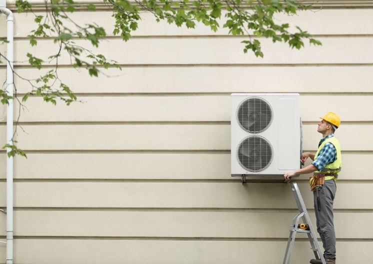

It copes in Scandinavia and their winters are way worse than here
Do Heat Pumps Work in Cold Weather?​
josh jackman
Written byJosh Jackman
Updated on26 January 2023
✔ Air source heat pumps work at temperatures as low as -25°C
Heat pumps are still three times more efficient than boilers when it’s below 0°C
