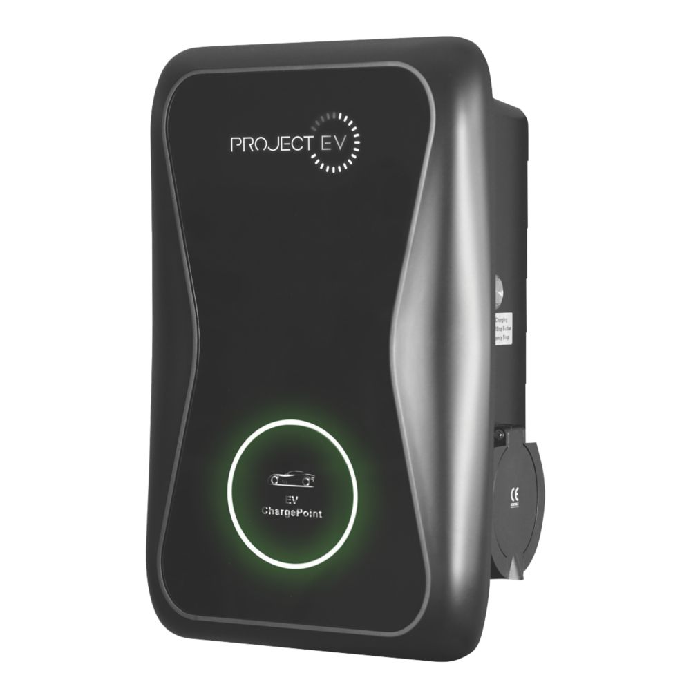

Why are these all so expensive? I paid £150 for a Project-EV charger (supply and fit) and as far as I can see has the same functions as all the most expensive ones. I can preset a charge based on cost, energy, or time. I also have the Solar Eco or Solar ECO+ option mode to use power just from solar pv's all of which work from an app. I've been using it for a couple on months and it has recorded that so far I have spent £4 on powering the car!

It was purchased as a package with a 5.9kW solar pv array and 18kWh FoxESS battery from Project Solar. I think I got them at a discount, but I guess you can buy them direct?
You received a large discount, the Project EV charger with PEN fault protection is over £500, not including fitting, cable, ancillaries (approx £400). An EV charger fitting company would ask for at least £500 for a "standard" supply & install with the £350 grant.
