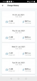

You cannot set a limit of charge on the battery but the safety buffer means it never goes to full 100%. I charge knowing that only 4 hours of 5p (at the moment) 28kw of electricity is topping up the battery.
I have never got more then 25kW or is that 25kWh in the 4 hours from my Ohme ?
