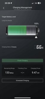

It’s more than a suggestion ;-)

I thought the only 3 phase cars were the MG4 and that was only the first batch and was a mistake?
MG are refusing to “officially” say anything but the MG5 Trophy charges at 11kW on a 22kW type 2 charger with a 3 phase cable…
Do you think this was another error?
