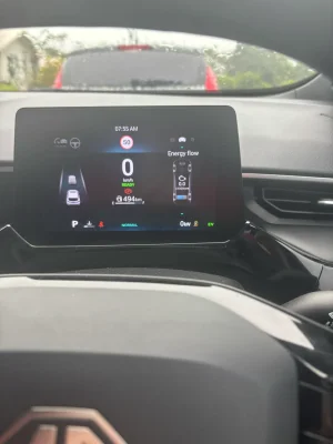

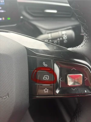

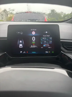

In relation to the high RPM, if you have the digital heads up display, you can scroll through the different options (by pressing the button that has been circled) until you have reached the "energy flow" section. I was taught a little trick in that section that when display shows 2.6 (where mine is showing 0.0 because its in EV), take your foot of the accelerator and quickly press it again - this will stop the car from over-revving in high speeds. Hope this helps! 😊
