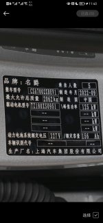

My car SE SR comes with a small label which clearly showing the motor model is TZ180XS0951.
Topline: motor model
Bottom line: motor SN

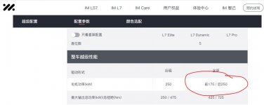

Just being really stupid, the175KW is from a different car, not MG4/Mulan.
I have missed the car's brand on the left top.
It's another SAIC brand: Immotors
immotors L7 or LS7
425KW in total. 175KW in on front axle and 250KW on the rear.
But again, the same motor on Immotors can do 175KW.
