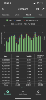

So…I’ve done a stupid amount of research into this so far.
Basically - if you are able to charge your car during the cheap period - and you can shift your washing machine and dishwasher to the cheap period too, you will defo save money!
My car is arriving soon (hopefully), and based on my usage so far - so no charging, but load-shifting my washing machine and dishwasher usage to the cheap period - as you can see comparing the new go trriff, and the standard variable tariff they are coming out as pretty much the same - so these figures cancel each other out - so I’ll focus on the car charging.
If I add the car charging onto this - say 7kw*4 hours every night being 7.5p x 28kwh - that will work out at £2.10 per night/per charge. If I charged this much at the standard variable it would be 28.29p x 28kwh which would equal £8.03, or a saving of just shy £6 a night compared to the variable. Basically if you can load shift and get a comparable average price/kWh on go compared to the standard variable rate (and if you charged your car for 4 hours every night), you’ll save £2171 (based on 10,000kwh used - but…realistically who will charge their car ever single night and out 28kwh in each night - so if you use roughly 3000kwh to charge the car over the year - rough saving of £650 per year compared to the variable rate tariff.
Right onto your tariff - firstly - if you’ve just finished your fixed tariff with Eon, I don’t understand how you’ll get those rates, as you would have been switched to their standard variable rate which should be at least 28p/kWh & probably a higher daily rate after April 1st, and it will be going up again in October.
But anyways, let’s look at that tariff you've got the image for (even if I don’t think that’s the tariff you’re on).
Basically you’ll need to either charge your car more often, or shift enough usage to the cheap hours to make it financially viable - if you’re using 400kwh per month it works out at roughly £80 spent for your usage (not including your standing charge) or your car charge which would add roughly half of that if your putting 210kwh in (so total £120).
If you didn’t shift anything and just charged the car at the cheap rate which would be maybe 210kwh - that would cost £15.75 - then your day usage of 400kwh would equal £142. So in total £158.39.
With the higher daily charge to, you’d be adding about 7 quid on top of that as well.
So, with those figures, it’ll be best for you to stay where you are.
BUT….if you can shift your washing machine, tumble drier, dishwasher to the cheap rates, you will bring that down - and I’d say they would be similar to those rates. BUT…I think the rates you have there are the standard variable rates from prior to April 1 and they have gone up to closer to 28p/kWh and 50p standing charge per day - which means that GO would be cheaper going forward.
So the graph below is the last month of my usage (including load shifting of white goods) which shows even without charging I’m actually saving a tiny bit by being on octopus go with my usage - it really is worth your while to go through your smart meter data to see where you use the most electric and to see if you can load shift it.

Thank you so much for this John. I'm going to have a proper look into this tomorrow at a more coherent hour, to do your response the justice it deserves!

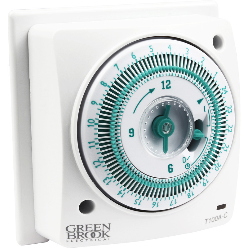

We have a fairly modern gas boiler that we us to heat our domestic hot water.
We have a storage hot water cylinder that has a electric emersion heater element installed.
This is never used, because heating the hot water was always more cost effective using gas.
But now after the huge price increase in the price of gas, I have decided to install a timer control to the emersion heater and it now we heat the water on the cheap rate off peak tariff.
Our washing machine is also fitted with a delay timer control, so that is being used on the off peak rate also.
Our EV gets charged in the small hours also.
It’s very important to try take full advantage of that off peak rate and slide as much of these high usage items as you can.
One point to consider here !.
When sliding high demand items into that window, that you consider what demands you are placing on your main cut out fuse.
We only have a 60 Amp fuse protecting our incoming suppy.
Quick “Man Maths” tells me that charging the car and heating the water alone is getting a bit close ( 45 Amps ) to the safe working limit of that fuse.
Running the washing machine also is to close for comfort !.
I have now contacted our DNO to ask for a main protection fuse upgrade to either 80 or 100 Amps.
Just something to consider, when sliding a lot of your usage to the off peak rate.

I’m also looking at something to control the immersion on my hot water tank - I’ve got a Simple on off switch, but would like to automate it (possibly app based too), so I’ve been looking at time switches and fingerbots, but not found the perfect thing yet…any suggestions?
I considered an App based switching option, but decided to keep it as simple as possible.
I switched out the single gang switch plate for a single plate mechanical timer.
A British made unit from Tool Station for about £12.
I will try and find the link.
