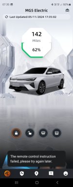

try refreshing the app by pulling down with your finger from top to bottom of the phone screen. (assuming it's connected/bound to your car).
I've done that. This is what it is showing me.
at the top of the screen it says last updated yesterday at 17:35 so it seems it's working but not all the time? that happens occasionally and I don't know why but guess it also depends on the signal strength ...
