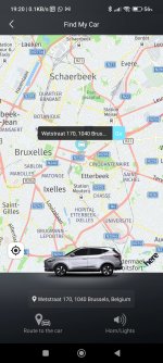

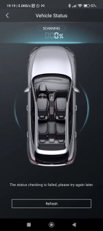

I have been trying to use the iSmart App most of the day but after first showing the car details at around 13:40, it has stopped working...
I have tried some most of the suggestions on this forum, including clearing the App cash, the phone cash, logging off the app and phone, locking unlocking the car using the key fob, switching the phone off for a few minutes and back on again. Also tried with the WiFi on and off. The phone coverage is great, with 4 bars out of 5.
In desperation, I uninstalled the App and re-installed it again.
Not only it's not showing the car details but it shows that the car GPS is somewhere near Bruxelles!
It knows where I am in UK and if I click on Find My Car, it shows the route to take to that destination. 😅😢😅😢😅😢😡😡😡
Not a great start with the MG experience, after all I only collected the car today...
Any help it's appreciated.
Thanks.

This is weird... The app will not scan the car but it knows that the car is parked. It shows this on the Remote control screen.
Also, if I tap on the central lock, it will unlock the car, and the wing mirrors open up.

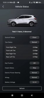

I have just dropped into the App and health checked it twice and this is what it is reporting right now.
Ambient temperature is around 25 degrees with a light cool breeze here in Wales.
Temperature will affect air pressure. You'll get lower readings in the winter and higher in the summer.
Happy to report that the tyres data is still showing correctly.
