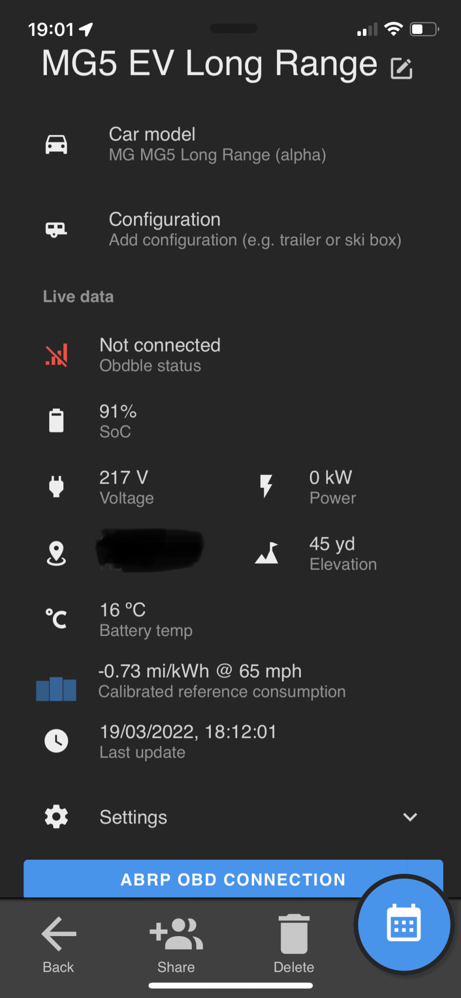

However, I'm sure I'm missing something or not read the manual properly but not able to get live data working from my Bluetooth OBD adapter Vgate iCar Pro Bluetooth 4.0 OBDII which will communicate with Car Scanner but not showing in my list of Bluetooth adapters on my phone. Any ideas? Do I need to try another Bluetooth adapter/

Don’t connect to phone through Bluetooth settings, connect through the ABRP app

My MG5LR is communicating, but initially shows the correct SOC and then drops to 31% and a silly number for battery temperature - think it occasionally shows the correct SOC again intermittantly.
I tried Car Scanner and the SOC looks correct and stable there - so think it's an ABRP implementation issue rather than my car or dongle.
MG5 profile might have been disabled as there are issues
