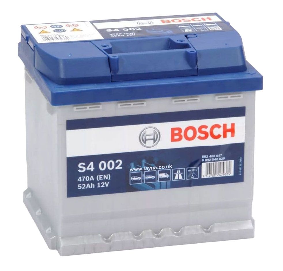

The invoice had this info on it BOSCH S4002 BATTERY 012 hope it helps someone.
The AA chap said that the battery failure is common on the MG and it goes with the radio failing
Thanks. Available from Tayna batteries for £58.58 plus shipping.
