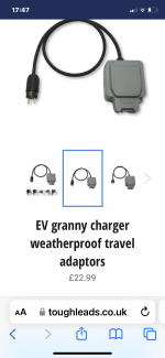

Okay thanks. I've found this online. Anyone think it looks okay?

I did not know the mains voltage in France which is 230v and the granny charge if fine over there it will only work on a 230v input.
Just found this you may need to check there sockets at the place you are staying at.

Charger draws 10amps - so check what the site provides. Full French power is 16amps, but sites often provide less. Have a look at this site - free to register and tells you what connectors are available at the charger locations. Charging station map for electric cars | Chargemap
Get a good quality adapterfor the granny charger, ideally rated at 16amps. There's a warning on the charger about not using extension leads - I've used one (rated at 16 amp) without issue in France.
