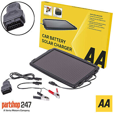

I don't suppose something like this can be used whilst the car is left can it ?
Only if the sun shines ☀️
