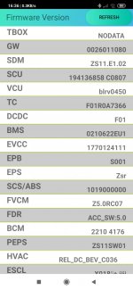

I would love to know from other owners what sort of voltage you are getting once fully charged. I have had the BMS update and have charged on my home 7kW charger numerous times with results varying from 440 to 446 volts after 100% charge and a long balance.
I don't think I have the update and I'm getting 456v at 100%. Is there a way to check if I've had it? I only have iOS devices...
If you’re getting 456v you won’t have the latest update bms which gives around 450v fully charged.
It means if you are getting 456v at full charge you have an earlier version of the battery monitoring software (BMS). If you are reading 449/450 volts then you have the latest BMS version number 0210622EU1, which was redesigned by MG to protect the battery performance, so it is worthwhile having the latest updated BMS software.
An owner can check the BMS version using an OBD2 device plugged into the cars diagnostic port and suitable software. (See attached phone screen shot taken from my ZS EV).
Hope this now makes sense to you.
