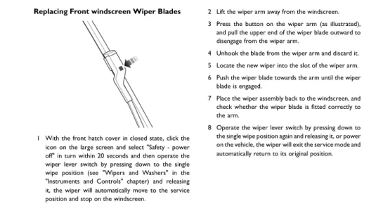

Help. Desperately need to replace front and rear wipers on my MG EV4 but getting conflicting information from different stores as to what we actually need. Does anyone have any exact codes for what’s required please.
These are the sizes listed on Wipertech, which fitted my MG4.
It seems difficult (impossible?) to find a clear rear wiper replacement in the UK? I have included a link to an earlier thread which both refers to a Bosch code (but this seems to be a set) and a DIY fix (not my bag), but has anyone in the UK bought and fitted a rear blade that works out of the box?
