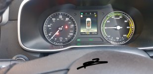

Hey guys, does anyone experience charging their mg zs ev, all night and only getting 109 miles out of 163miles... this milage in the weather is really not convenient for my busy schedule that I do in and around Birmingham only.. I pop in eco mode and have really cold heating. So have not choice to drive in normal mode which is 100 miles buy the time I get in the car an turn it on..
Doe anyone else experience any of these problem?

The most i get in eco is 115. But if I drive in eco the heating is really cold, is this normal?? and I never have my aircon on, plus I have the 163mile range,, I have never seen the full 163 even in eco with no heating on. This is the highest I have gotten from the car. I had it in September last year.. luckily I never have to use the motorway that was just a one off thank god.. the garage did have the car for 3 weeks over Xmas they told me it had a software issue. But gave me back 163miles but I have never gotten 163 after that..
I just wondered if any one else suffered the same problem.. but think it may be a weather issue too. As thats what the garage stated too..

Hi , I think you do seem to have a problem , weather should have little affect on the mileage reading at 100% charge with the accumulated trip reset and everything turned off HVAC etc . I have always got around the advertised milage range no matter what the outside temp is , my ZS is down to around 158 miles in normal mode now at full charge with battery degradation , which I think is good considering the car is over 2 years old .I do recommend the EV watchdog app using an OBD 2 adapter it will show what actual percentage you are getting on a full charge around 93% with the latest BMS , also the kWh available from the battery which should be close to 42 kwh , if you're not getting close to these figures then something needs to be looked at . It does seem suspect to me that the garage had your car for 3 weeks , they should be able to tell straight away the correct state of the battery , most of the cars that had the bad BMS I thought would have been fixed by now , but maybe your car is one that has not , hope you get it sorted soon 🙂

I regularly charge our Trophy LR to 80% SOC and it reports a predicted range of 212 miles on the GOM.
It has done this consistently until the temperature really started to drop in the last week or so.
The car is frozen solid at the moment and charged to 80%.
The predicted mileage has reduced to 199 miles at -1 degrees and -2 INSIDE of the car.
I will upload a picture of its current status.
