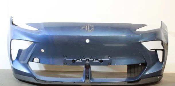

Would like to know if anyone removed the MG badge front and back for MG S5.
For MG4, the front is indented. Is it the same for S5?
Looking at this picture of a used one, it appears to be flat where the badge sticks on.
I think 99% of all badges / emblems are fixed with adhesive foam tape these days.
Bit of gently heat from a hairdryer maybe enough on a newish car, or if that fails, they a length of strong dental floss, used in a sawing action under the badge will do the job.
