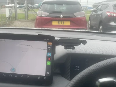

Phone holder.
Now you want one with the phone on the cradle, right? 🤣

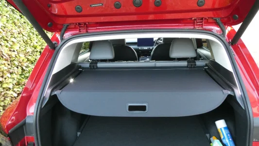

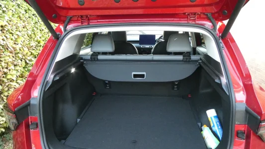

I got cheesed off with having to duck under the rear parcel shelf, so removed that and fitted a retractable type load cover.

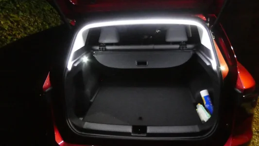

I have also fitted the boot surround LEDs.

Like that a lot where did you connect the led lights to
You pop out the little original boot light on the lefthand side of the boot, and the wiring loom supplied piggybacks onto the original boot light connectors. It's an easy fit, and I found a video on Youtube showing the kit being fitted to a Volvo.
