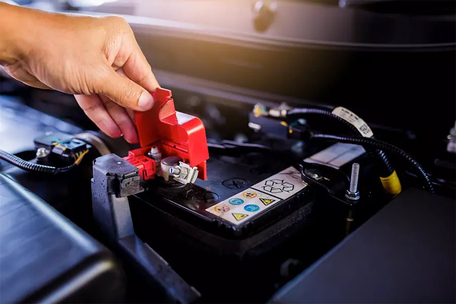

Update on my problem with multiple warning lights and bongs. My local garage checked the 12V battery and found it was fine. They also volunteered to check the diagnostics and found that all the warnings related to the radar at the front. This itself said it needed realigning/recalibrating. They had not got the kit to do that. So to the MG dealer. They said that the radar was loose because it's clips were broken, probably due to accident damage! A very targeted accident. £200 plus later, all fixed, bongs gone.
