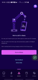

That is the IO Go tariff, so you should be letting Octopus do the scheduling not setting your own static schedule. The T&Csc state they can remove you from the tariff of you don't.
I got the 7.5p rate all afternoon and most of the early evening today.
Upvote 0
Upvote 0
Err, not sure what that screen shot is for, we know it's in beta, which is probably why they are being lenient with allowing people to manually schedule at the moment.
I really don't know why people are against getting more cheap rate electricity than the default, just let Octopus set the times for you 🤷‍♂️
They send out an email with the predicted best days to charge for the next 5 days. If you can time your charging to match those days, then you very often get the cheap rate as soon as you plug the car in no matter what time of day.
Upvote 0

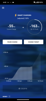

Sorry to keep asking stupid questions but...
I did the first charge last night, setting up a schedule of adding 100% by 6am, even thought it only needed about 40%> At around 6am the charging cover light was on solidly - so balancing I think - and has now switched off. On that basis it seems to have done what it should do and I've checked that the battery is fully charged.
What's confusing me is that the Ohme app is still showing the attached with the Current Charge still going up very slowly. I'd thought that there would be some sort of "charge ended" screen. Is this normal, because the MG and ePod can't talk to each other fully?
Upvote 0
When the charge ends, mine just flat lines until I unplug it, then the charge gets added to the stats with the correct cost (ish).
Upvote 0
