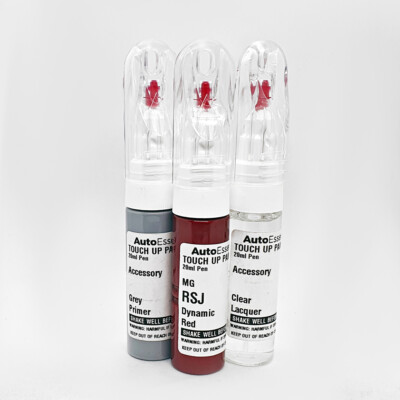

on ebay they offer a primer too - how should it be used ?
If the stone chip is really deep, with bare metal exposed, then you can use the primer first.
It will help build up the depth of the layers of paint and provide a key for the colour and top coat too bond.
Remember not to use a lot primer as you need to allow space in the chip, to accept the colour and then the protective lacquer ( if it’s two stage paint ).
If the stone chip is small, then the primer is not 100% necessary.

RSJ - It is Dynamic Red ( see below ) and the MG part number of the paint is clearly shown.
The OEM MG touch up has two bottles, one containing the base coat and second containing the lacquer.
