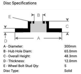

Further searching. Seems like this type of brake disc (Febi 104496) is used by other car makers, including Ford, Aldi, Skoda & VW. One site, autodoc [1] states that it is compatible with
