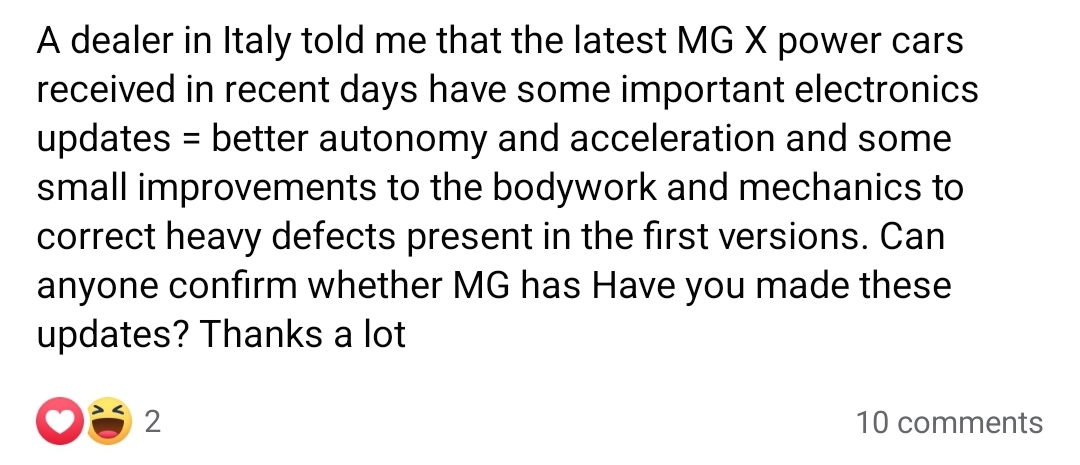

In France, it seems that the Xpower models delivered since the beginning of February do not have the vibrations...

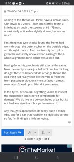

Was just going to play ex-VW fan boy and say the ID.3 was fine so wondered if all VAG the same, but Enyaq appear to be exactly the same as MG4! See attached:
The plot thickens...
