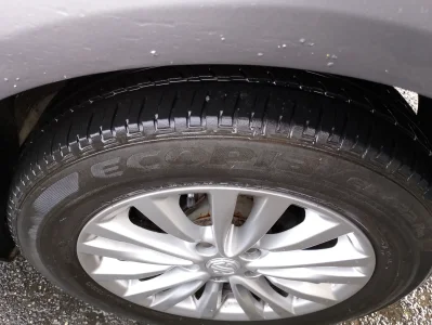

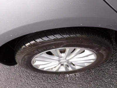

I purchased a 2021 Mg5 long range Exclusive from Arnold Clark, 5 weeks ago. Yesterday I discovered blistering on the rear wheel arches which wasn't there when I bought the car.
Has anyone experienced similar problems, and what are my options ?

its a bad repair either filler getting wet or rust getting wet and blowing the paint, take it back
It's had s quick blow over over possibly before Arnold Clark bought it? It's rust and it will be expensive to fix, take the car back for either repair or refund

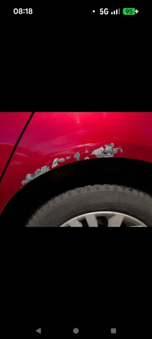

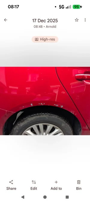

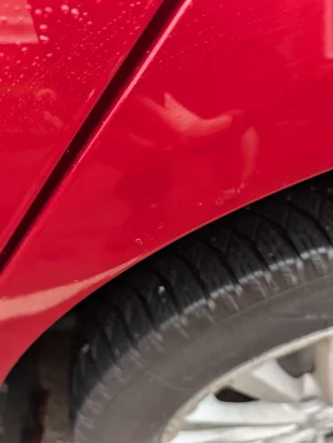

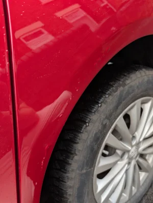

Yes.. mines a lot worse tho 😭
It's been a long old battle.. 2 unsuccessful repairs from Arnold Clark to date, started coming back through just 48 hours after the last repair attempt!! I'm at my wits end tbh
That's terrible @butters19851, are your repairs being done under warranty ?
Arnold Clark have dealt with it so far as mg said it was void of warranty as the vehicle hadn't had full corrosion checks done.. despite the vehicle having full mg service history 😭
It's no surprise really it if has a full service history the corrosion checks should have been done. We only had a small bubble and the dealer and MG made a right horlics of it all! I will get Mt smsll blemish dealt with by the bodyshop next door after I have cleaned it up and inserted metal to repair it
That's cobblers. If it's got a full MG service history, then it's got a full corrosion check history. Simple's. If it's not marked down as done (or more likely not even looked at) that's there fault. As far as I'm concerned, it doesn't matter, it's part of your MG service. 😡
