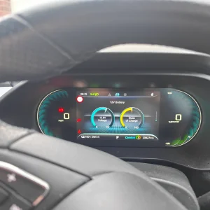

I do 1 HR journeys daily and also plug in overnight
The below image is from 7am after an overnight charge....no schedule restrictions so has been plugged in constantly...50% charge
Isn't the 12V meant to charge as well.. I'm sick of panicking every morning that the battery won't be charged.. already had RAC out once to jump it as it fully discharged while I was away.

Yes, the CCU will charge the 12V battery every time the HV battery is connected (READY or charging). What voltage does it show when READY?

Nothing wrong with 13.8v surely or am I missing something?
The 13.8V is supplied by the DC/DC section of CCU and is not indicative of the 12V battery health.
Starting the car with HV battery disconnected will ensure that all low voltage circuits are powered directly by the Aux battery.
If its voltage drops quickly below 12V consider replacing it rather sooner than later.
