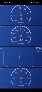

I'm getting more useful information from a bluetooth OBDBLE dongle & an app on my phone, it's a shame the dash can't tell me the same information but that's the problem of cost cutting.
Using the dongle and app I can at least see what's going into the battery, it's not ideal and if you accidentally leave the dongle in when the cars locked the alarm will go off frequently (don't leave the dongle in when your not in / near your car!).
I'm hopeful overtime there will be more useful telemetry available via the app.
Which dongle and app are you using? Also do you have the SR or LR 5?
