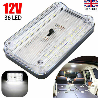

I assume this comes on at same time as front light? Dims the same, etc? Does it come on when either the driver/passenger light buttons pressed? Can it be operated separately?Hi
I totally agree it should have been there from factory, it was dark in the back but even darker when I had the windows limo tinted
I didn’t take any photos of install as I was trying to get it done before the rain came?
Just put your fingers at the front of the interior light and pull it towards you in an arc (spring loaded at front clips at rear of light)
There are 2 black wires to each bulb I just snipped them and soldered them together then put them in terminal blocks just for a bit more security
At the light I was fitting I just measured central location marked the hole to cut
Then very carefully cut the hole with a sharp Stanley knife
Connected the wires to the light fitting with two insulated femal spade connectors
Then job done
Hope this helps
I will try n take photos when weather breaks again
