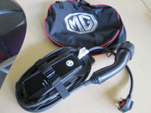

Here's an MG one on eBay, 2nd hand but might be OK - good price
EDIT you are sure there isn't one - from memory, in mine, it's in a modest size bag in the netting on the right hand side of the boot - could easily be missed.

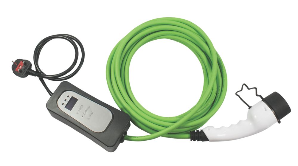

Try and get one with 6A, 8A and 10A settings. I got one from a Kia and drop it to 8A so the plug top doesn't get so warm.

The one I linked to appears to be a car dealer (Focus Car Sales), he has another one up for sale too. I suspect it's his way of making a few extra bob - sell a 2nd hand EV (like yours) but don't pass the the granny on and make an extra £100 on each sale.
Yep I carry one of those instead of the MG one specifically for that reason, charged at 6A when away and the socket was still a little warm so kinda glad I wasn't trying to pull 10A the whole time.
