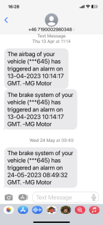

I still get the occasional text from a very long number telling me stuff is happening to the car (photo below)
It haunts me and taunts me. 😢

When my car was declared an insurance write-off I had to fill in some form for the DVLA to tell them I had transferred the car "to the motor trade". Presumably the same for a rejection?
