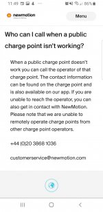

Cheers , thats a great help .who,s helpdesk did you phone Aldi or Newmotion and?
New motion helpdesk
+44 (0)20 3868 1036

Just rang newmotion and somehow got the netherlands instead of uk ,but on second attempt got uk . Apparently it is offline and they are going to do a re-set so all should be hinky dory soon .thanks for all the help.
