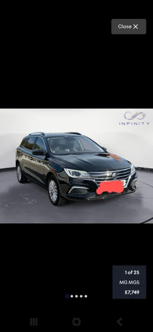

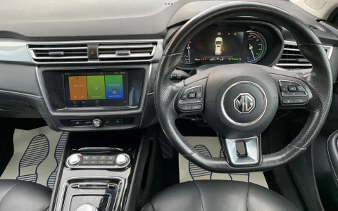

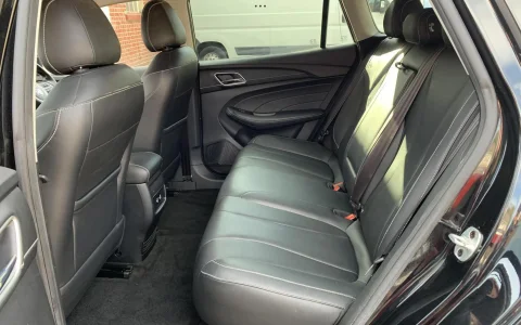

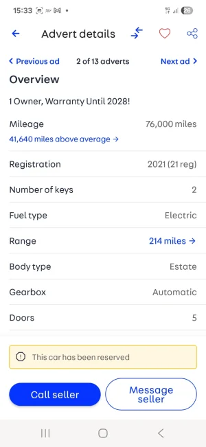

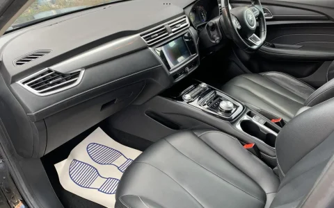

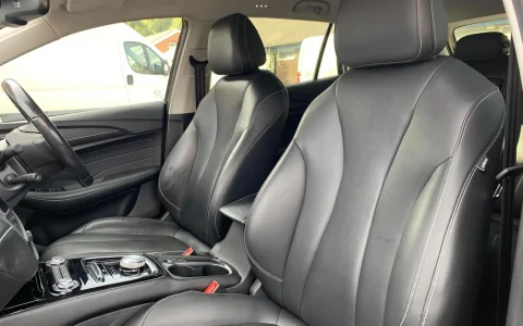

I brought a 2021 sr exclusive for £7500 in September full MG service history 76k on clock
Great car , just some leather damage on drivers seat
