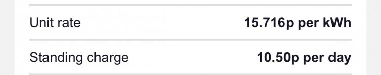

Im paying
Electricity Unit rate19.656p per kWh
Standing charge 25.1496p per day
That is actually quite expensive both unit rate and standing charge if you are not taking any advantage of cheaper rates. I was on this prior to going Octopus. Try Uswitch.
Thanks for advice what is day time rate when you have a low night time rate
My Octopus Go is 15.18p/kWh standard and of course 5p/kWh for 4 hrs per night. Standing charge is 25p/day. Even this is cheaper than your current tariff. You must be paying an arm and a leg at your rates with the hot tub.
